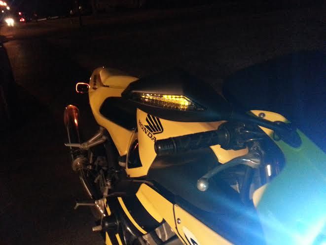

Any idea why they're not all shining bright? When viewing the bike from the front the upper-inside corner LEDs are very bright some of the others are dim and then the outer-lower corner lights don't seem to be lit at all. Both lights are like this. This bike has flush mount turn signals on the side that the previous owner installed. Could an aftermarket relay or something cause this? Or maybe resistors? Just guessing here. The flush mounts have the 3-2 wire converter-clips, not sure if that makes any difference. Thanks a lot!

Possibly a lack of power and for a LED light to be suffering lack of power there must be truly something amiss. I'd check the connections some people have all sorts of odd ideas what makes a good electrical connection.

I'm no wiring expert but everything else is working okay. Someone else said to try an aftermarket relay or in-line resistors that can up the voltage. I don't know much about either of these but I may get one and just leave it laying around until I take the front fairing off again, which I despise doing.

A resistor or relay will not up the voltage in a DC circuit, to up the voltage in a DC circuit you have to invert it into AC use a step up transformer then rectify it into DC and you'll most likely blow the snot out of your 12volt LEDS as they are designed for 12 volt.
LED's are polarity sensitive unlike globes you have hooked them up the right way? Are they dim or trying to flash very very rapidly if so you'll need a flasher relay designed for LED's.
