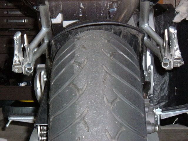

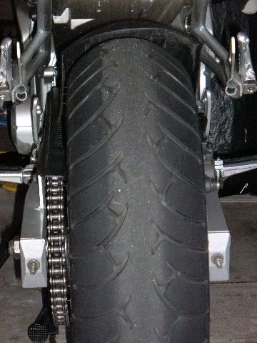

My hugger is off-center pretty badly and I was wondering that other peoples huggers looked like. I've looked at it and taken it off and not sure what could be wrong. Could it possibly be from when I lowsided and somehow that bent the swing arm?:eek: I'm probably over paranoid about this but wondering what else it could be. The hugger itself does not look bent when I took it off. Its hard to see but here are some pics. The hugger is almost touching the sidewall of the tire on the left side.

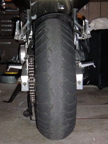

Here's a pic of mine for reference. Yours does look a bit off to me. If the bike's been down, I'd be guessing something got bent. Any possibility it could be the two tabs that the chain guard side mounts to? They could be bent, which would skew the whole thing.

Thanks for the picture crx, I did check the two tabs and one looked a little bent. I bent it back so it was straight and the position of the hugger didnt change, so I'm stumped.

Can you take a pic of the right side of the hugger, particularly the mounting points? It almost looks like the mounting is off somehow on that side, causing things to be crooked. I can't remember how it's mounted right now, but I know there's a little metal bracket on that side that might have gotten oriented wrong.

looks like this part is bent which seems to be causing the problem
