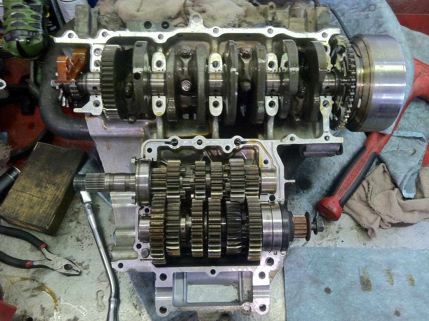

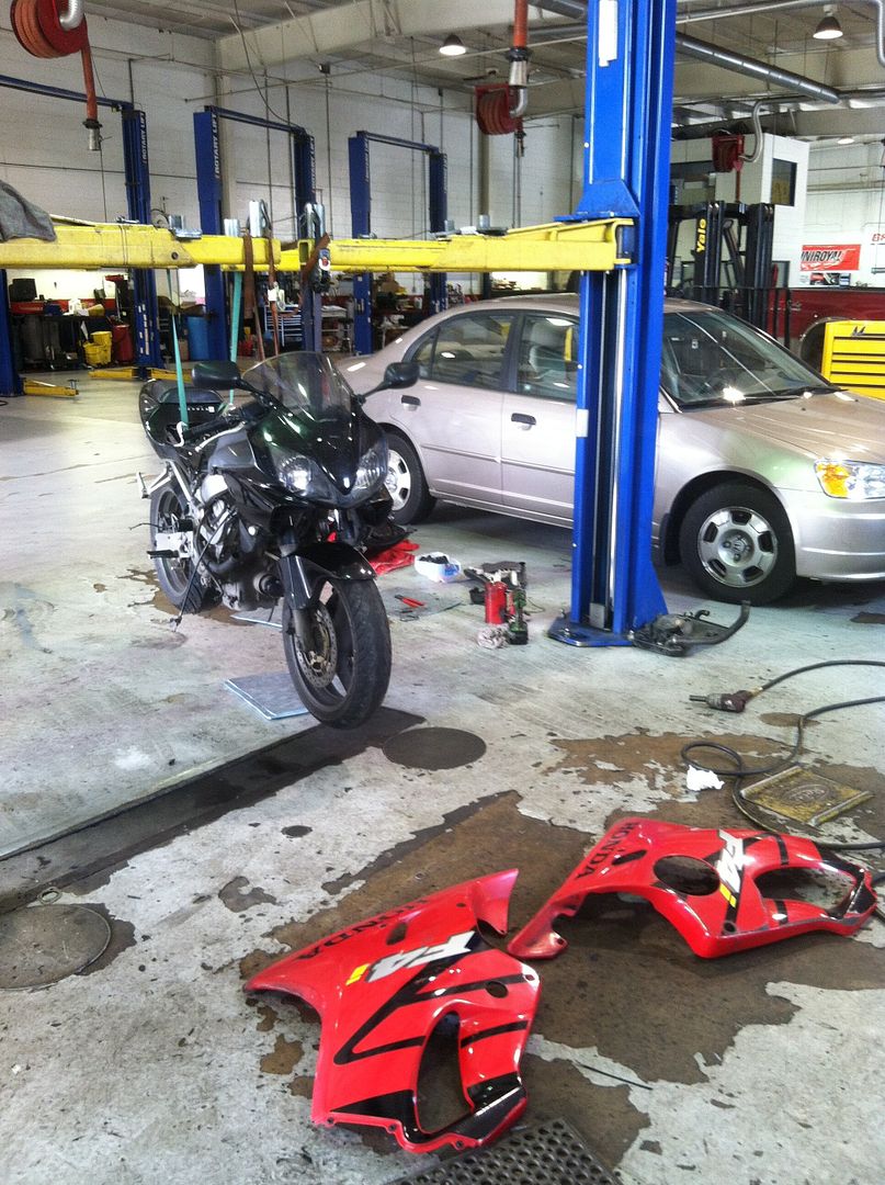

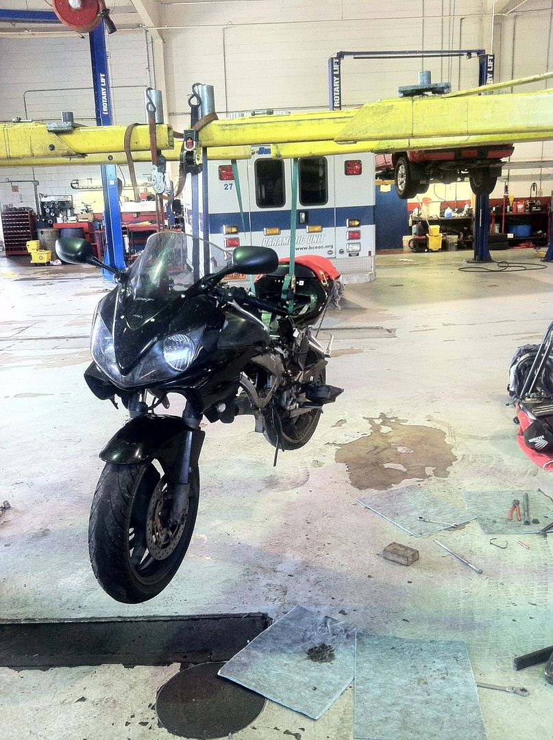

So here recently my bike decided to start jumping out of 4th gear..... nothing real bad but if you got on it say to pass a car or something, or shifted into 4th at higher RPM it didn't want to hold too well. Got a trackday coming up on Sept 6-7 and really didn't want to have this going on during that. So had to kinda hurry and get the parts then get it out and apart. A buddy came over and gave me a helping hand and we had it out and apart in no time. Actually got it all back together today as well (motor wise), but I've gotta check the valves on monday and put new plugs in it too

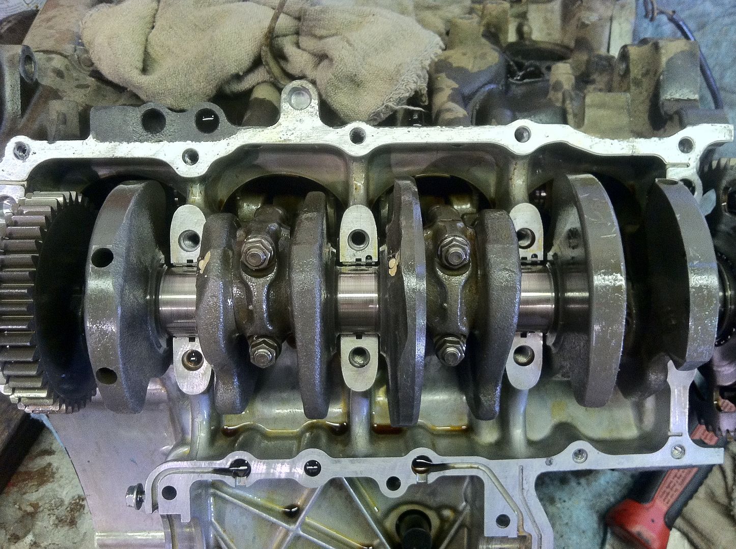

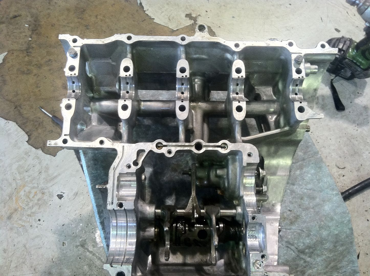

Anyways hadn't updated with the rest of the progress yet..... I had gotten the trans fixed and the motor put all back together (cases and whatnot) the same day I took it out, and then been working on it here and there during the week when I wasn't busy at work. Got the valve adjustment all done..... it was really weird, almost all of the intake valves were tight, while almost all the exhaust valves were spot on perfect. Usually it's the other way around, lol. But got them all adjusted perfect in spec. Now just gotta put the new plugs in and replace all the radiator/coolant hoses..... I figured it's probably time, they're still original (starting to crunch a little when you squeeze them)
A few more pics..... the worn gears and shift fork. Can see the rounded off ears. Both are completely original gears
Cases all put back together
