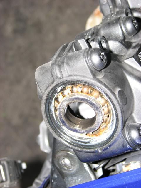

so finally broke down and replaced my dead steering bearings, which have been dieing a very painful death for the past 8k km (19k km total on the bike). Since I had everything apart installed the R6 forks and brakes that have been sitting around for probably the past two months. Finally got my Garmin power wire and Ram mount a few days ago so figured I would install that as well. I hate messy wiring so I figured why not add an accessory fuse box at the same time.
The bearings were pretty straight forward to do, a lot of hammering on various things and it was done. Accessory fuse box not so much, had the bearings/forks done in an afternoon, the fuse box took me three days. Mostly because I had to run around trying to find the fuse box, ground box, and various other little things while still working during the daytime.

no surprise on the bearings when I took them apart
bottom:
top:
both together:

bearings were $20, the forks/brakes/adapter kit/Galfer lines cost me $200cdn from someone local who sold his FZ6 and didn't get around to putting them on.
and yeah, the bearings were done a long long time ago, I just kept on riding on them. The top ones probably could have been cleaned up, but the bottom ones were completely pitted and corroded, I guess that's what 19k km of riding in a lot of rain and never repacking them will do. I really liked it naked too, that's a project for another day though
